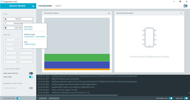

  • Yes, I can program all kinds of programs. I have tried to look deeper in the issue, and the main issue since the mcu boot pop up message in nrf connect desktop is that when I reset it, and replug it, it is reverted back to the programmed state and not the reset state(for any program). The burned applications seem to be working, but as I intend to use usb cdc(which had worked perfectly before), it does not work, and the programmer goes to mcu boot mode. I get the error:
    22:26:18.844
    Error: Failed with exit code 1. One or more set mcu state tasks failed: * D8AB43AFAAC5: [mcuBoot] Non supported device for setting mcu state, code: Argument. Message: Failed to set mcu state on D8AB43AFAAC5, [mcuBoot] Non supported device for setting mcu state.
    22:26:18.844
    Error when fetching device versions: Error: Failed with exit code 1. One or more set mcu state tasks failed: * D8AB43AFAAC5: [mcuBoot] Non supported device for setting mcu state, code: Argument. Message: Failed to set mcu state on D8AB43AFAAC5, [mcuBoot] Non supported device for setting mcu state.
    ps: this is where the problem started:
    (I am using NrfConnect for Desktop. I was testing different programs on my dongle, and I clicked write in nrf connect without resetting the dongle first. I got a pop up that now mcu bootloader will be used to program it, and I realized my mistake, so I clicked cancel, instead of Ok, and reset the dongle with the sideway button.)
    In any other normal application it does not enable mcu boot, so works application wise, but the reset problem persists:
