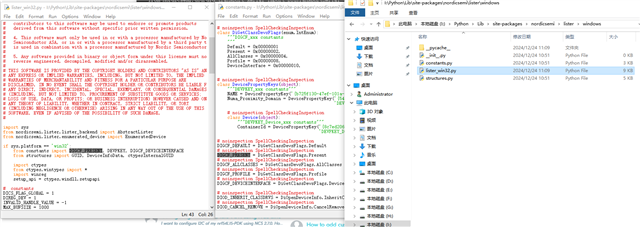

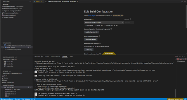

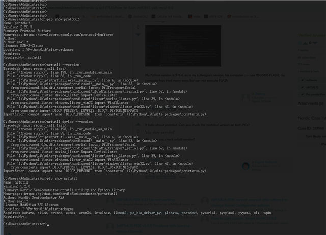

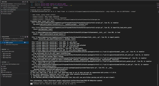

Flash ends with error messages:
build messages:
I'm I tried running west flash --recover.But it didn't work.
Finally I ran "nrfjprog --program merged.hex --verify" on CMD ,successful.
How can I successfully FLSAH Nrf54L15-PDK on VSCODE?
