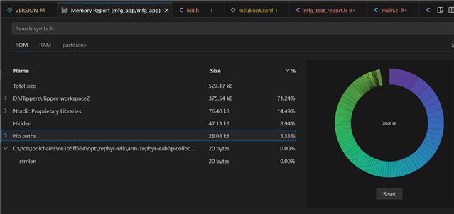

I'm finding the built image to be 486 KB after size optimization (-Os). The image includes a 130 KB firmware for an external component. That leaves the application size as 366 KB, which seems rather large. In addition, the image is expected to grow as motion algorithms are added.
Looking at the memory report some of the largest items are
Nordic Proprietary Libraries 76.4 KB
bluetooth 47 KB + net 2 KB
Hidden 43.48 KB
No paths 38.2 KB
littlefs 16.8 KB
nanopb 5.7 KB
logging 4.27 KB
nvs 2.9 KB
I'm working with NRF52840 which has a 1MB capacity. I want to have mcuboot with DFU so at least 32KB (?) would be allocated for mcuboot, I want to reserve at least 12KB for NVS. The space available for 2 slots is therefore limited to 980KB or 490 KB max image size.
Is there any way to reduce the size of "Nordic Proprietary Libraries" ?
Is there any way to reduce the size of bluetooth?
What is going on with "Hidden" and "No path" items, why aren't they combined with their original source file?
