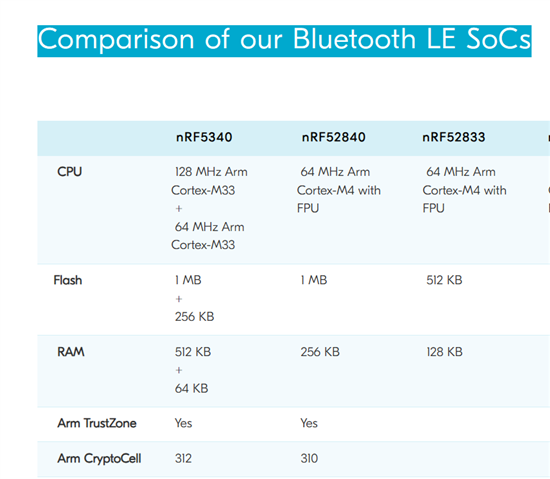

  • Apologies for my continued confusion, but I still have a few questions.
    1. Why is the nRF52840 a better option than the nRF52832? Does it have more RAM storage available?
    2. According to the ring buffer library, ring buffers are declared using RING_BUF_DECLARE which will "declare and statically initialize a ring buffer with a specified byte count." I want to make this as many bytes as are available in RAM, but I still don't know how to do this. Should I just use an arbitrarily large number and assume that it will allocate what is available? Is there a way to find out how many bytes are available for use in RAM?
    Thank you.
    Yes. You can find following comparison from Bluetooth Low Energy (Bluetooth LE) - nordicsemi.com. You can even consider nRF5340 if the only concern is RAM size..
    Yes, it is possible to monitor the RAM usage by your application, then you can adjust your ring buffer size accordingly. I have shared methods on the following thread:
