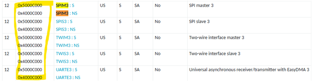

    The driver should handle everything, so as long as you use the driver in the same way as the test examples that is all you need to do.
    The SPIM4 do not share hardware resources with other instances, ref:
    https://docs.nordicsemi.com/bundle/ps_nrf5340/page/chapters/memory/appmem.html#ariaid-title3
    spim3 share with spis3, twim3, twis3 and uart3:
    spim4 don't share with other functionality:
    The pin assignment tables show recommended usage:
    https://docs.nordicsemi.com/bundle/ps_nrf5340/page/chapters/pin.html
    If there is no specific recommended usage for a pin, then it can be used for anything. The spi pins can use those pins that have labeled qspi usage, if qspi is not used.
