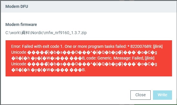

  • The error screen is shown below.
    Attach the log file.
