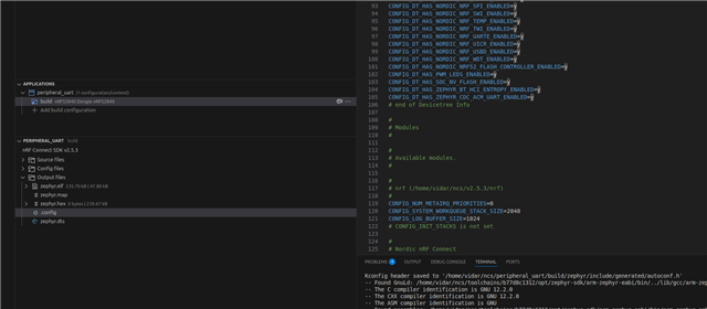

  • Thanks fort sharing this. Unfortunately, I'm not able to spot any errors in your *.dts snippet either. Is your project a multi image build? I'm wondering if there is a chance the error is reported for a child image such as MCUBoot or similar.
    Does your generated config include the "CONFIG_DT_HAS_NORDIC_NRF_USBD_ENABLED=y" line as here:
