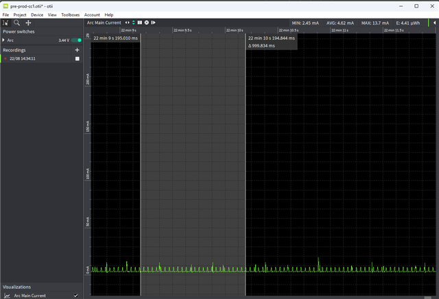

    Some more data: all on my custom production board with input at 3.44V from an OTII Arc.
    1/ running with only BLE GATT service on the nrf5340, no wifi, no other radios, waited for 30s for everything to go to sleep (touch sensor mostly)
    - average 4.62mA, min 2.45mA
    - little peaks of around 8.8mA every 40mS
    - peaks of around 13mA approx avery 300mS : this is the BLE beacon tx I think
    2/ running with no radios active, same other conditions:
    - average 4.56mA, min 3.22mA
     - peaks 8.6mA every 40ms, no others (no BLE tx)
    The BLE tx processing on the nrf5340 is pretty low power, not an issue.
    I have eliminated about 1.2mA base consumption from previous test due to correctly sleeping my ISO7816 interface chip.
    I still have a 2-3mA base load... and I don't know what the regular 40mS peaks could corrospond to?
    Any ideas?
