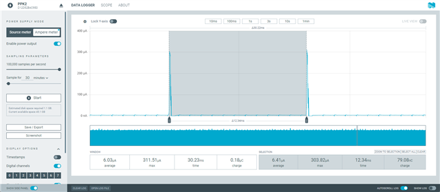

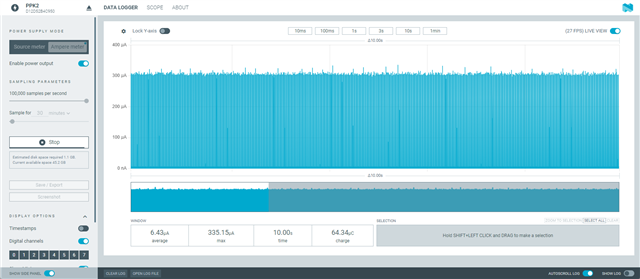

  • Hi
    I made some more detailed tests now. Following PPK2 measurements are made directly for the MX25R64 supply line:
    So as you can see, here are the ~6.5µA I was looking for.
    When I zoom in, I can see some peaks every ~12.4ms.

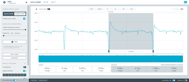

    And even if I zoom more into, I can see some actions every ~1ms that still consumes ~4µA.

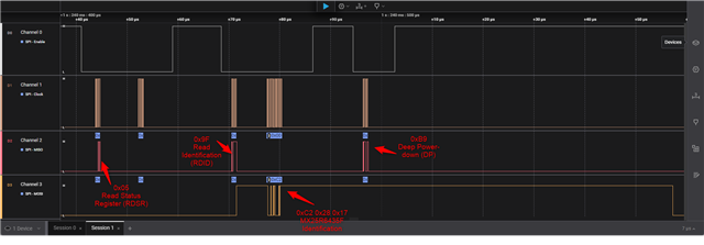

    When looking on the SPI I see the following:
    So looks like the dpd (deep power down) command was really sent. But why is the external memory, still consuming so much power?
