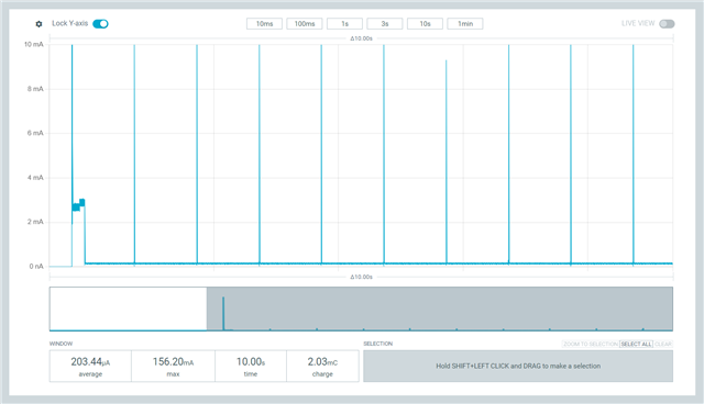

    i'm seeing the problem related to HfXtal_stop(), which i've modified to not only included wait-states but also to test that the XO and PLL are indeed not running....
    if i do *not* call HfXtal_stop(), everything works just fine -- except that i'll draw 100s uA of current when in 'deep-sleep' awaiting the RTC interrupt:

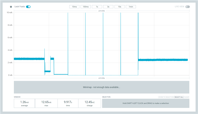

    when i *do* call HfXtal_stop() after the RADIO is in its DISABLED state, i can execute 3-8 wakeup-sleep cycles before encountering a HW memory fault:
    when working, i'm not drawing 1.5uA when in 'deep-sleep'....
