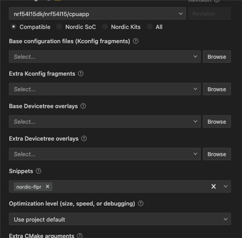

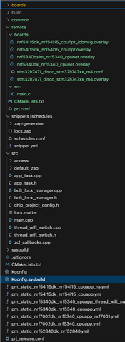

    As I mentioned, the goal is integrate with Matter door lock.  I copied the  zephyr/samplessubsys/ipc/ipc_service/icmsg  source files to Matter door lock and tried to build as a starting point.  Please see below picture for folder structure.
    The remote code was moved from icmsg code.
    nordic-flpr snippet is included.
    When I tried to build the matter door lock sample + the flpr, I get the below build error.

  • Sorry for delayed response Subu,
    I am not an expert at this configuration but maybe we need to use the right pm_static setup for the sysbuild+Matter.FLPR
    It might help to rename/delete pm_static_nrf54l15dk_nrf54l15_cpuapp_ns.yml in your project folder and add the app: FLPR memory section section in the pm_static_nrf54l15dk_nrf54l15_cpuflpr.yml (after creating one) instead
    Open pm_static_nrf54l15dk_nrf54l15_cpuflpr.yml and add something like below or the one that matches your memory layout if it is different
    app:
      region: sram_remote
    Make sure you are using sysbuild and then add this to your CMakeLists.txt file
    if(CONFIG_SYSBUILD)
      sysbuild_add_child(app
        SOURCE_DIR ${CMAKE_CURRENT_SOURCE_DIR}
        DOMAIN app
      sysbuild_add_child(remote
        SOURCE_DIR ${CMAKE_CURRENT_SOURCE_DIR}/remote
        DOMAIN remote
    endif()
    as shown in the second part of that change, add folder "remote" in your project folder and add a file "domain.yml" inside the remote folder and add this below content to that yml file
    build_by_default: true
    The folder structure should be something like this after the changes
    root/
    ├── prj.conf
    ├── CMakeLists.txt         ← With sysbuild_add_child
    ├── pm_static_nrf54l15dk_nrf54l15_cpuflpr.yml  ← This is important
    ├── remote/
    │   ├── domain.yml
    │   ├── src/
    │   │   └── main.c
    │   └── CMakeLists.txt     ← For FLPR build
