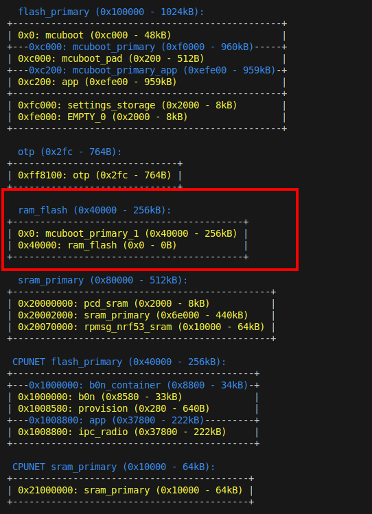

Partitioning and mapping:
What’s the cleanest way to define partition layout (e.g., viapm_static.yml) to store both images in NAND and allow MCUboot to find them? -
