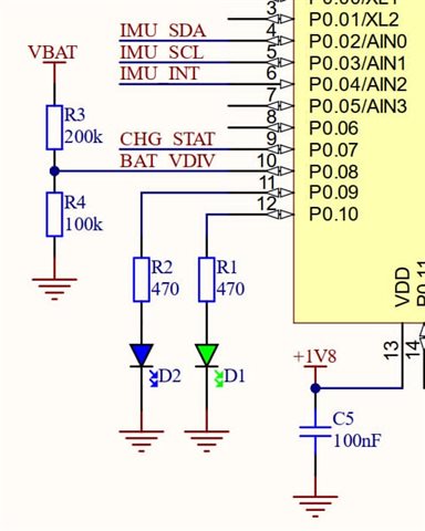

I'm having issues with a custom design board using NRF52832_QFAA SOC.
This is the snippet of the schematic design that my group created:
This board uses internal DCDC, 2 external GPIO LEDs, an instance of I2C and the 32MHz oscillator.

Right now we are trying to flash a few test programs into the custom board, 1 to test the 2 LEDs and 1 more to test Bluetooth LE Advertising. The 2 applications built successfully using the custom board, but when we flashed the .hex files into the custom board, none of the functionalities worked. We used both "west flash" from the VSCode extension and JLink's J-Flash utility.
At this point we are not sure if our hardware design or software design is flawed or missing any details. And we have no clue how to troubleshoot them.
Any help is really appreciated. Feel free to ask for relevant extra details about our design.

  • Hello  , hope you have a good day.
    I want to ask how to drive led with gpio like the setup I have (pull down led, active high). I should have make it active low but .... And the voltage between P.10 (mesure by the R1 pad) vs GND is just 0.8V.
    Is this purely hardware fault or something else in the code?
    P.S: Just trying to salvage the rev1 of this board, currently working on rev2 to impliment some fix.
