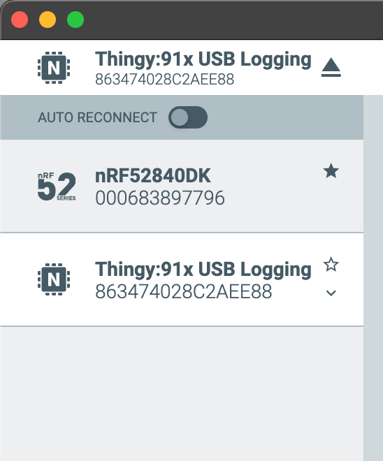

Hi, It's looks like I bricked my Thingy:91x . It was working fine when I program it with the target "thingy91x/nrf9151/ns" then later while learning I try program the in the "thingy91x/nrf5340/cpuapp" after that I can't program device anymore in both target any other methods..
I try to connect with J-Link Lite CortexM and nRF52840-DK as debugger but failed. I can see the device in the nRF Toolbox Programmer
The Thingy:91x USB Logging is the thingy:91x USB Serial and above is the  nRF52840-DK debugger.
and when I try to choose the device and Erase all

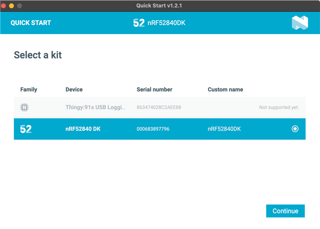

This is window I see when I open the Quick Start Guide.
