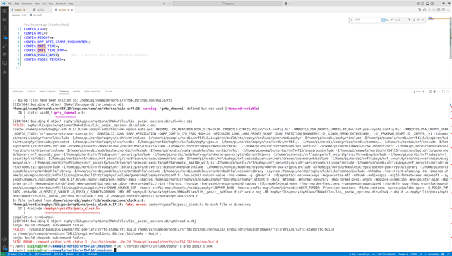

The error shows that one variable you have declared or defined (grtc_channel), but you have not actually used it anywhere in your code. This is a common warning or error in C/C++ development, especially when using strict compiler flags.
To resolve this, ensure that you use the variable in your code, for example by passing it to a function. Otherwise, you have to remove this.
Can you please share your application folder?
Kazi Afroza Sultana The unused var won't cause build error.
The main reason is the header not exits.
I don't want talk more. just show your code which is a complete project.
It won't be difficult for your verder, but cost much time for us costumers.
Thanks.
