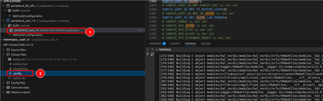

    -88 (-ENOSYS) indicates that the UART async driver API is not enabled, at least not for this UARTE instance. Please try adding CONFIG_UART_2_ASYNC=y to your prj.conf and watch the build output for any errors/warnings, and if not, see if you still get this runtime warning.
    Note that you can also check your current configuration from the generated .config in your build output.
    However the latter seems to be forced disabled in the build as I cannot find it in the generated .config file as you indicated.

    I've not investigated why enabling CONFIG_SHELL is affects this configuration. However, you should be seeing a Kconfig warning in the build log saying why CONFIG_UART_2_ASYNC does not end up being selected (I'm assuming it is not set in the .config since it's not working). Try to also add the line below and see if that fixes it.
    CONFIG_UART_2_INTERRUPT_DRIVEN=n
