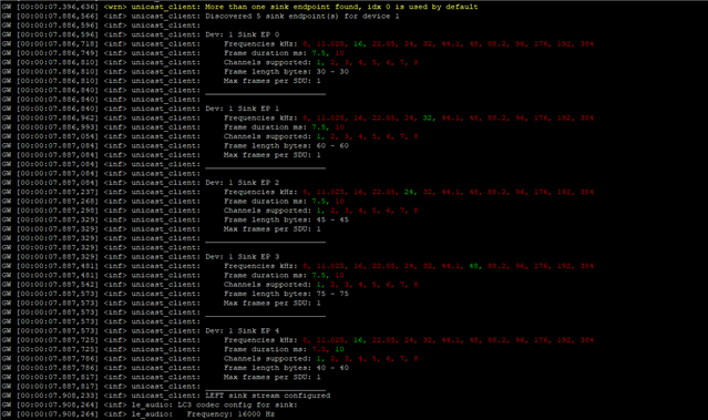

  • Hi Min,
    Could you try adding CONFIG_BT_BAP_UNICAST_CLIENT_ASE_SNK_COUNT=20 CONFIG_BT_BAP_UNICAST_CLIENT_ASE_SRC_COUNT=20.?
    Our gateway already supports TWS stereo. Please also let us know which TWS you are working with.
    Swathy

  • Hi Min,
    Could you please provide the full log.? The "memory capacity exceeded error" doesn't mean the HCI memory, might related with the wrong configuration setting which controller cannot handle. Also include the following:
    CONFIG_UNICAST_CLIENT_LOG_LEVEL_DBG=y
    CONFIG_BT_BAP_UNICAST_CLIENT_LOG_LEVEL_DBG=y
    CONFIG_BT_AUDIO_EP_PRINT=y
    Providing a log like shown below would be helpful:
    Best Regards,
    Swathy
  • Also,
    Please let us know which TWS earbuds you are testing this with.. Our team has tested with a few TWS earbuds with nRF Connect SDK v3.0.2 and that seems to work.
    Swathy
