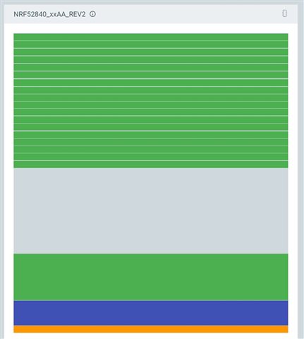

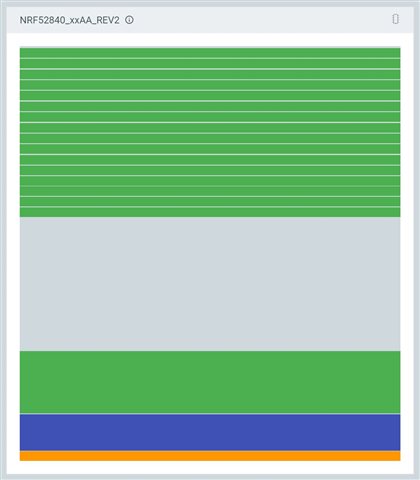

  • Hi Hieu
    in the post 8 day ago i tried to show where the assert happend and what the log output writes, i had added this part after the first version was deployed in the field, so far i expected some issue in this code area.
    The compared memory layout below (the Bootloader was not shown in this view)
    Old Version
    flash page end at 0x000EF000
    New Version
    flash page end at 0x000EE000
    Memory Layout old Memory Layout new
