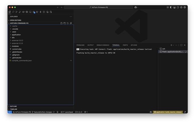

VS Code extension updated to 2025.8.654. Now when I click flash it says
Executing task: nRF Connect: Flash: application/build_reactor_release (active) Flashing build_reactor_release to nRF52 DK
And sits there spinning. Running west flash manually works.

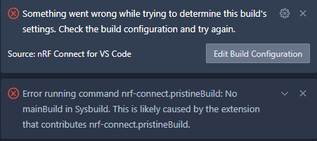

Extension Features > Runtime status has 5 uncaught errors, all "No mainBuild in Sysbuild"

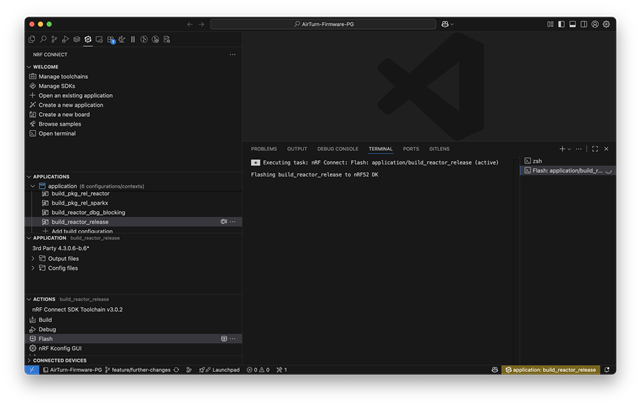

I'm using a west workspace. my app is in "/application". /application/west.yml:
manifest:
self:
path: application
remotes:
- name: nrf
url-base: https://github.com/nrfconnect
projects:
- name: sdk-nrf
remote: nrf
path: nrf
revision: v3.1.0
import:
path-prefix: external-3.1.0
clone-depth: 1
The extension says the SDK is "third party" with the version being the version of my App. This seems incorrect.
