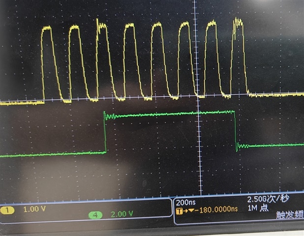

  • Add Update on Issue 2 (SPI communication with ADS1299):
    I found the data lines show square waves, but the SCLK looks a little bit rounded(yellow for sclk, green for miso). Is this normal? I also observed the same waveform on 2.6.0. Will this cause any problems?
    Could you try running a BLE sample from the SDK to see if the same issue persists? I suspect the problem might be due to the netcore image not being created correctly.
