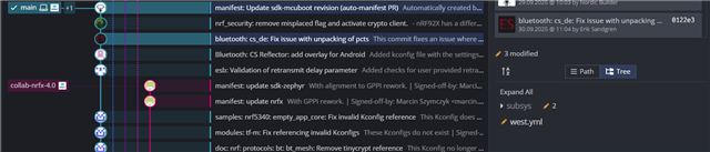

    Please, can I manually switch to the main branch in the ncs repository? The mentioned commit is already merged in the main. However, when I do that, I can't compile it with the 3.1.1 toolchain - am I doing something wrong?
    I switched to commit 560d4f7b09e2b58630a4e8c867f5be068173072e
    Then I created new project from sample - RAS initiator.. but build can not be done without errors.. Missed I anything?
    The build fails with multiple Kconfig symbol definition errors in the Nordic SDK's Bluetooth controller configuration:
    1. BT_CTLR_EXTENDED_FEAT_SET (Kconfig:538) - Symbol defined without specifying data type
    2. BT_CTLR_SDC_EXTENDED_FEAT_MAX_REMOTE_PAGE
    3. ....
