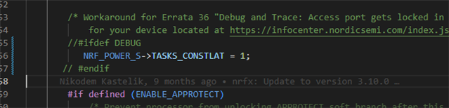

    I think the issue you are seeing is due to the errata where the access port gets locked in WFI and WFE.
    Try commenting out lines 55 and 57 in: ncs\v3.0.1\modules\hal\nordic\nrfx\mdk\system_nrf91_approtect.h, See the same here

  • Hi Abhijith,
    The issue is fixed now, using this workaround.
    Thank you for your support
