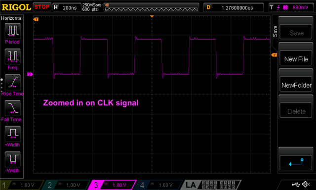

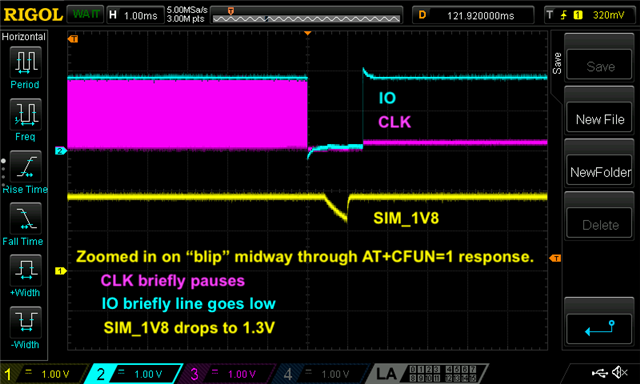

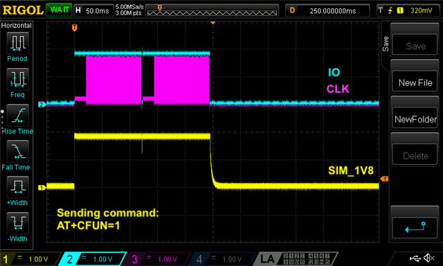

    We were able to get probing of the lines after we run AT+CFUN=1
    From our HW team:
    We also tried testing with and without a SIM card populated and the results are still the same.
    • When issuing a command like AT+CFUN=1 to enable the modem, the SIM_1V8 goes high, the CLK line begins to PWM, and the IO line goes high but there is no other data on that line.
    • Partway through the AT+CFUN=1 response, there's a brief moment where clocking stops, IO goes low, and SIM_1V8 drops to approximately 1.3V with this "blip".
    • When issuing a command like AT%XSIM? there is no movement on any three of these lines, including nothing on SIM_1V8. Everything stays at 0 even though we receive a %XSIM: 0,9 response on the terminal.
  • Hi Jennifer, Greg,
    Great ideas and thanks for getting to the root cause of this! That was it -- the primary issue on our end is that the SIM card holder we used in this run of boards didn't have an internal switch that connects C5 to GND when the SIM is installed, so C5 and therefore our SIM was never getting properly grounded.
    After grounding C5, we're able to correctly communicate with the SIM and see activity on the IO line with responses for all of the commands I was previously issuing. We're in the same place now with our boards as the DK.
