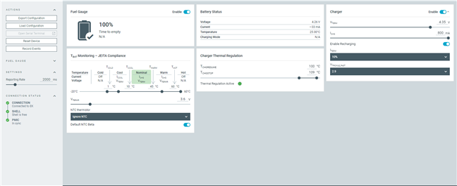

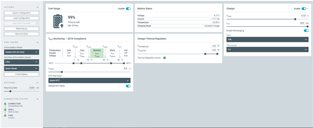

    I also tried with another battery to verify the behavior:
    • Battery: 3.85 V, 1200 mAh Li-ion
    • Charging current: 800 mA
    • Termination voltage: 4.35 V
    • Trickle/Fast charging threshold: 2.9 V
    • Charging termination: 10% (default)
    • The first attached screenshot shows the charger operating in Constant Voltage mode, with a battery voltage of 4.37 V and charging current of 111 mA.
    • The second screenshot was captured after charging completed — the application reports 100% full, but the actual measured battery voltage is 4.26 V, while the expected set termination voltage is 4.35 V.

    This is due to battery behavior and internal ESR and it is completely normal to have higher cell voltage with 111mA charging current vs when there is no current sourced to the battery. The battery voltage will also drop slightly when rested due to the battery chemistry. This is considered already on the fuel gauging during the battery modelling that the rested voltage is not the same as the termination voltage.
    The higher the charging current the higher the termination current and that makes the step bigger when charging stops.
