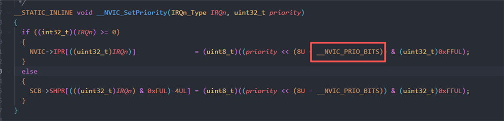

     I ran a test:
    when Timer2’s interrupt priority is set to 1, Timer0 and Timer1 interrupts cannot preempt Timer2’s ISR;
    when Timer2’s priority is changed to 2, Timer0 and Timer1 can successfully preempt it.
    In the tests above, all the AIRCR.PRIGOUP values read were 0x0.  According to the CM33's preemption definition, the priority grouping for Timer1 and Timer2 is different under these two configurations, allowing for preemption.
  • Hi tubyjk,
    Let me summarize:
    1. AIRCR.GROUP=0 means the format is ggggggg.s
    2. There are only 3 priority bits for nrf9160. So that format will be "gg.s". And this accord with what you tested on Timer.
    And I got your question:
    Wen you set priority value b00000010, in this function it will be convert to b01000000
    But the default value of AIRCR.PRIGROUP is 0. You think this could become b0100000.0
    This "bit-shift" seems not be mentioned in Cortex-M33 specification.   Do you have any idea about this?
