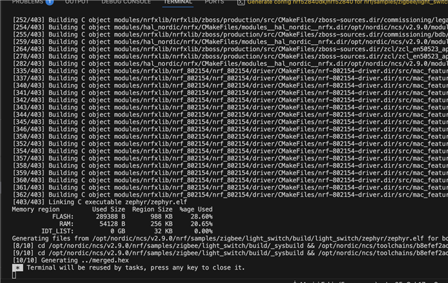

  • i tested with this prj.conf on NCS2.9.0 on light_switch using VSC
    1401.prj.conf
    And everything builds fine with NRF_SECURITY ENABLED
  • Wonderfu  l!
    I'm able to build it now! Thanks!
    But, I sureley misunderstood, but even with the light_switch firmware my nrf52840 remain undiscoverable from Home Assistant (using Zigbee Home Automation)... Do you know something about this?
    Thanks again!
