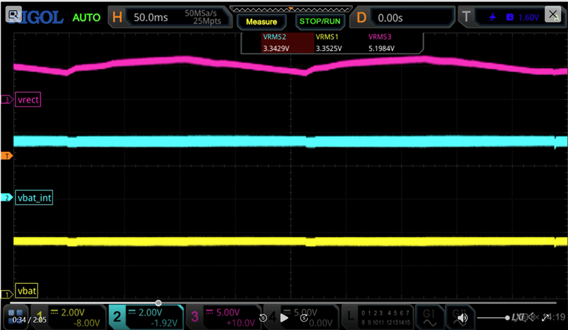

  • Hello Asbjørn,
    I have attached a movie recording three traces and their time domain characteristics as the nMP1300 enters battery charging likely in trickle charge mode (fw to 20sec to see the temporal modulations).
    VRECT in the top trace is the AC/DC rectifier output of the wireless power RX, that feeds a 5V buck regulator that has its output connected to nPM1300 VBUS input.
    The ADC measurement and data readout in the application is slow, at a rate of 1/5 seconds, it does not correlate to the rate of voltage modulation that I have seen. My current hypothesis is that is either caused by the buck regulator's switching scheme, or the nPM1300 charging logic especially if the charging algorithm cahrges the battery using a pulsatile current rather than DC.
    Your thoughts?
    Thanks and best regards,
    Kostas
  • Hello Kostas,
    Here are my observations from the video:
    - It seems the VRECT starts this sequence of modulation. At 22-23 seconds of the video all three signals show a voltage drop. Is this when the charging engages? This stage lasts from 12 seconds until saw tooth ripple emerges on - Vrect and Vbat is showing repeatable small drops on the voltage.
    - At 34 seconds though, just before the saw tooth on Vrect, there's a really short pulse noticeable on all domains, see the one to the right here and after that the saw tooth start on Vrect. Vbdomains then show
    - The saw tooth increases in frequency after a couple of seconds and not visible on Vrect after. The saw tooth is visible on Vbat until 46 seconds where it seems Vrect goes back up towards 6.2V.
    - Another cycle of this starts at 1:09.
    Q1: Again Vrect drops down to 4.1V from 6.2-6.3V. Is this dop expected from the buck that feeds VBUS?
    Q2: What does VBUS look like?
    Q3: Is the wireless charger able to deliver enough current to sustain this? Suspect that that VBUS drops as Vrect drops and it's not capable of delivering enough current. That's why there's a 2V drop on Vrect.
    Is it possible that the nPM1304 with the option of smaller charge currents could be an alternative for you?
    Best regards
    Asbjørn
  • Hello Asbjørn,
    Your observations are correct. The sawtooth-like fundamental frequency changes from ~4Hz to ~60Hz and the onset of VRECT rising up seems to be triggered in response to load current picking up on VSYS, or by Charger temporarily start/stopping injecting current into the battery. When VRECT drops below 5V the downstream DCDC regulator that feeds VBUS is no longer in regulation mode i.e. its output voltage VBUS simply tracks VRECT. This is caused by the wireless charger source impedance that varies across coupling distance and dynamics in the load that the nPM1300 plus downstream active consumers.
