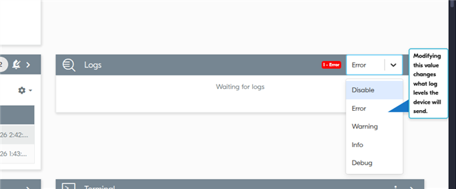

    6. Changed the logLvl to a different value so it is reported to the device the desired value.
    As I couldn't see any issues neither reset in the serial log, I proceeded to update the Modem Firmware from 2.0.2 to the latest 2.0.4. The updated succeed and no issues were reported in the serial log.

    The logLvl can be changed here:
    A few questions:
    Which mechanism are you using to change the shadow properties?
    Are you using the nRF9151? Which Modem firmware? Which NCS version?
    Pascal.
