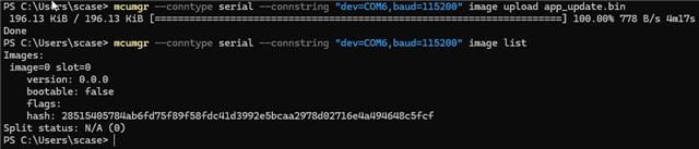

  • Thanks Abhijith. Here's what I did and the results:
    • I took the partition file you attached on your last post and used it for my pm_static.yml, after renaming the old pm_static.yml.
    • Did a pristine build.
    • Boot my board in bootloader mode.
    • Uploaded the newly-generated app_update.bin to the bootloader via serial with mcumgr
    • Asked for a list of images from mcumgr (mcumgr --conntype serial --connstring "dev=COM6,baud=115200" image list)
    • It says that the image is not bootable, which is the same as before.
    Then I think, "Maybe the problem is the image that was already on there." I re-flashed the board using nrfjprog, before uploading the image to the bootloader again, repeating the steps above. So what I did was upload an image that is the same thing as the existing firmware already running on the board. At the end of this sequence, I checked again, and again it says that the image on the board is not bootable:
    This firmware, when flashed to the board, works fine. There is nothing wrong with the firmware itself. But the bin being generated by NCS is refused by the bootloader. It has been pretty consistent about this since I've been using mcumgr to do testing. I just can't figure out what is making this bin invalid.
  • Partway through this troubleshooting, I started using this as an indicator for "Is it good or not?" because it seemed to simplify things:
    I do "image list" with mcumgr and look to see if it says the image in slot0 is bootable. Every time, it says false. I understood that as indicative of the problem. But apparently, these images can actually boot despite what it says, because I can hit the reset key after uploading an image and having it say its not bootable, and the firmware comes up. Why is that? I wonder if this has led me down the wrong path with my troubleshooting.
