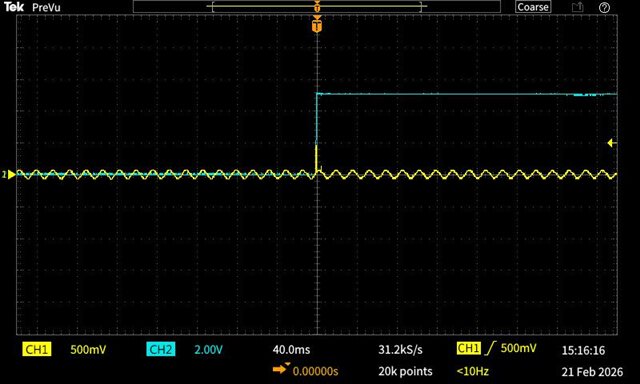

  • Probing other GPIOs shows similar pulses.  Looking around the internet, I see indications that this is not uncommon on MCUs in general, though I haven't found a specific instance of Nordic SOCs.  Could you ask one of your EEs to comment on this?  If the pulse cannot be eliminated through setup within the application software, what would be the recommended method of connecting a GPIO port to other electronics - say a simple case of interfacing to a transistor operating as a switch?

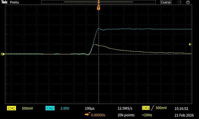

    I'll add a couple more pics.  As above, the yellow trace is the nRF52840 Dongle GPIO pin (P0.13).  In these new images, blue is the 5V supply from my electronics going into VBUS on the dongle.  The second pic is zoomed in on the area of interest.
    Ken
  • Hi Ken,
    I discussed this with one of my more hardware oriented coworkers who suggested adding an external pull-down resistor between the GPIO pad and the transistor gate to ensure the signal is not floating on startup.
    Vidar
  • Hi Vidar,
    I had tried the pull-down resistor before using a rather high value (10k) without success.  Using a lower value resistor (2.2k) seems to allow dissipation of the startup pulse without switching on the transistor.  This becomes a balancing act to keep the "on" circuit current minimized and still pulling enough current on startup to pull down the pulse.  Never the less, this conversation helped me ensure there was nothing else in the software I could or should do to prevent the pulse.
