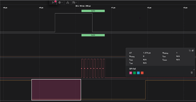

    SPI fail. No debug connection:

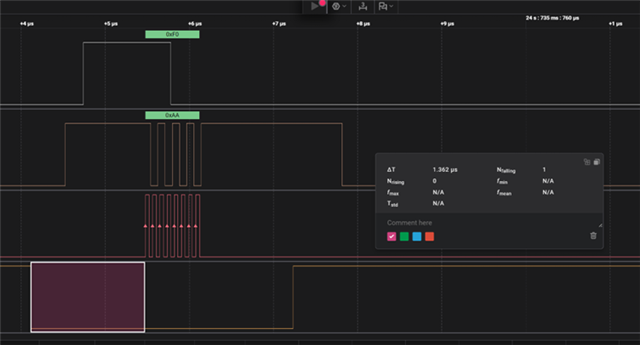

    SPI OK, RTT connected:
    There is no activity on MISO when SPIS fails.
    Only difference between these captures are that the first is with RTT not connected, and the last is with RTT connected.
    Debug output backend is the same in both cases.
  • There is no activity on MISO when SPIS fails.
    It's probably responding with the default DEF character (0x0)

    I have added a high resolution timer to the ST bootloader now, so I can set the CS to first clock pulse more accurate. It actually seems like the limit for SPIS is at about 2us. I have measured the timing more accurate when SPIS fails as well, and this is actually 1.3us.
