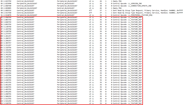

We have the following environment:
1) nRF54H20-DK v0.9.1 and our custom board
2) nRF Connect SDK v3.2.1
3) Our simple project for testing BLE
4) nRF Connect for Mobile app
5) Our custom board has an external 32.768 kHz crystal
Before testing we have connected and bonded our device with nRF Connect for Mobile app.
Then we turn device off and on (power cycle) and try to connect to our device from app.
If we use nRF54H20-DK the connection is established successfully every time.
If we use our custom board sometimes we get the connection error 8. Both device and app show this error.
Also we have other samples of our custom boards. Some of them work well, but some ones have the same connection issue.
How can we debug and fix the issue?
Thanks
    If the same code can work on some of your custom boards, but some ones have a connection issue. Then, I would suggest you check the hardware.

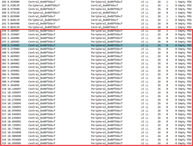

    Your .pcapng logs show the peripheral side didn't interact with the central.

    I was asked to take a look at this ticket, and everything here points to the issue here being with either the HFXO or LFXO crystal on your custom boards either being mounted poorly or loaded incorrectly.
    These error messages in the past and the fact that some boards work correctly points very much to this being the case.
    Can you:
    • Upload the specifications for the crystals you're using in your design so we can verify they are suitable for your design. (Both 32.768kHz and 32MHz)
    • Share details on how they are loaded (I assume you're using internal capacitors and not external ones)?
    • Verify with a scope or similar that the external crystals are outputting the expected frequencies and that they are mounted physically correct on the boards. A common mistake here is to mount either crystal 90 degrees the wrong way if it has 4 mounting pads, and that would result in these kinds of errors as well.
