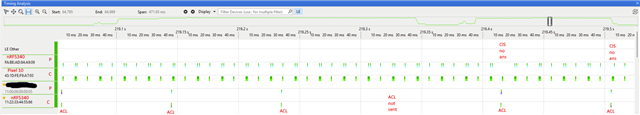

Sniffer capture of the CIS_REQ packet:
The Audio received on the nRF5340 has some clicks in it.

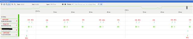

These are some captures from the sniffer (Teledyne LeCroy Sodera) which showed that the nRF5340 periodically misses some CIS events form the Pixel 10 phone.
The nRF53 also acts as Central for a Peripheral device, on an ACL connection, with a very high Peripheral Latency, around 80.
Please see below and example of the nRF5340 not responding to a CIS event from the PIxel 10, and the Pixel 10 repeating the payload in both subevents of the CIS.
I noticed that the missed CIS events seem to happen immediately after an ACL event with the other device.
Is it possible tat the nRF5340 prioritizes the ACL over the CIS and that is why it is missing the CIS event?
Technically, it has enough time to figure out that the Peripheral did not answer and catch at least the retransmission from the second CIS subevent which is ~1.6 ms from the end of the ACL packet.
The clicks were not audible in the previous SDK we used, 3.1.1. Has the behavior changed since then?
If this is the cause of the missed CIS is it possible to configure the device to always prioritize the CIS over ACL (maybe with the exception of special situations like connection update instants)?

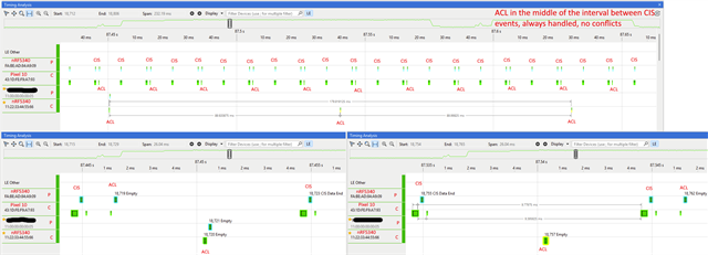

    A third mechanism I implemented to solve the audio issue was to disconnect the Peripheral whenever the Pixel 10 starts the audio stream on the CIS. I did this to force the nRF5340 and the low latency Peripheral to re-connect so the nRF5340 can choose a timing for the ACL which does not conflict with the CIS.
    This mechanism mostly works. Most of the time the nRF5340 schedules the Peripheral ACL, on re-connection, in the middle of the interval between CIS events. And in this situation, the audio is fine. See the screenshot.

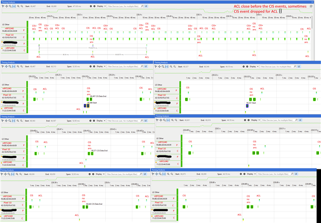

    But other times it schedules the RC ACL very close before the CIS event. Initially this works fine, but suddenly the nRF5340 starts missing CIS events again from the Pixel 10.
    Apparently, it starts missing CIS events after and ACL with the Peripheral where the Peripheral does not respond.
    The Peripheral eventually responds but the nRF5340 keeps missing CIS events from the Pixel 10.
    I suspect this is an Window Widening issue and the Window Widening is not reset correctly once the Peripheral responds.
    Please ask the Controller team what they think about this.
    See the following screenshots for this issue.
    Initially no CIS events are missed:
    But later all CIS events following the ACL with the Peripheral are missed.
    The issue starts here where the nRF5340 does not send an ACL event to the Peripheral for some reason:
  • It doesn't seem like window widening is the cause here; it seems like this is still a scheduling conflict. Regarding the secondary ACL where the 5340 is the central, unfortunately, the application is unable to control the anchor point of the first connection event (whereby all other connection event timings are based off), and the controller does not take into account the CIS peripheral activity when setting up the secondary ACL. This aligns with what you are seeing, and if the initial connection anchor point lands in a good position after reconnection, it should remain conflict free (with the 90ms connection interval). But if not then scheduling conflicts will occur. Unfortunately, the controller does not support any mechanism that can mitigate this. If possible, you can try to keep disconnecting until the secondary ACL initial anchor point falls in a better location.
