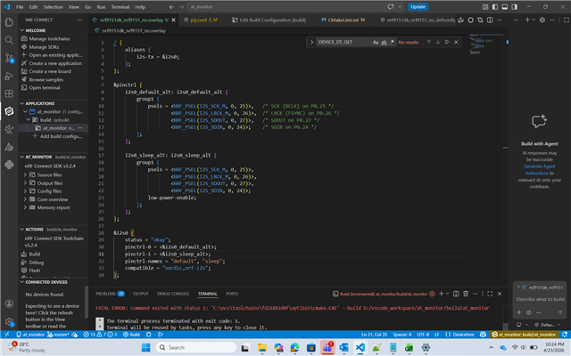

    Based on your suggestion, I’ve captured the full pristine build logs, along with the overlay snippet and relevant project details from my setup. Even though the overlay structure matches the expected pinctrl-based configuration, I am still running into build‑time devicetree errors (including NRF_PSEL() evaluation issues and pinctrl-related failures) in my setup.
    I am sharing below:
    • The overlay file currently used in my project
    • The complete pristine build logs for reference
    It would be very helpful if you could take a look and let me know if I’m missing any nRF9151‑specific requirement (for example, expected pinctrl include paths, differences in _ns build handling, or any prerequisite configuration when enabling I2S).
    Thanks again for your support and for sharing a buildable reference. Looking forward to your guidance.

    There are 2 errors from what I can see from the logs:
    FAILED: CMakeFiles/app.dir/src/tlv320dac3100.c.obj
    C:\ncs\toolchains\fd21892d0f\opt\zephyr-sdk\arm-zephyr-eabi\bin\arm-zephyr-eabi-gcc.exe -DKERNEL -DK_HEAP_MEM_POOL_SIZE=8192 -DNRF54L_CONFIGURATION_56_ENABLE=0 -DNRF9120_XXAA -DNRF_SKIP_FICR_NS_COPY_TO_RAM -DPICOLIBC_DOUBLE_PRINTF_SCANF -DUSE_PARTITION_MANAGER=1 -D__LINUX_ERRNO_EXTENSIONS__ -D__PROGRAM_START -D__ZEPHYR__=1 -ID:/vscode_workspace/at_monitor/include -ID:/vscode_workspace/at_monitor/build/at_monitor/zephyr/include/generated/zephyr -IC:/ncs/v3.2.4/zephyr/include -ID:/vscode_workspace/at_monitor/build/at_monitor/zephyr/include/generated -IC:/ncs/v3.2.4/zephyr/soc/nordic -IC:/ncs/v3.2.4/zephyr/lib/posix/options/getopt -IC:/ncs/v3.2.4/zephyr/soc/nordic/nrf91/. -IC:/ncs/v3.2.4/zephyr/soc/nordic/common/. -IC:/ncs/v3.2.4/zephyr/subsys/shell/modules/kernel_service/thread/.. -IC:/ncs/v3.2.4/nrf/include -IC:/ncs/v3.2.4/nrf/tests/include -IC:/ncs/v3.2.4/modules/hal/cmsis_6/CMSIS/Core/Include -IC:/ncs/v3.2.4/zephyr/modules/cmsis_6/. -IC:/ncs/v3.2.4/nrf/modules/hal_nordic/. -IC:/ncs/v3.2.4/modules/hal/nordic/nrfx -IC:/ncs/v3.2.4/modules/hal/nordic/nrfx/drivers/include -IC:/ncs/v3.2.4/modules/hal/nordic/nrfx/bsp/stable -IC:/ncs/v3.2.4/modules/hal/nordic/nrfx/bsp/stable/templates -IC:/ncs/v3.2.4/zephyr/modules/hal_nordic/nrfx/. -isystem C:/ncs/v3.2.4/zephyr/lib/libc/common/include -isystem C:/ncs/v3.2.4/nrfxlib/crypto/nrf_cc310_platform/include -fno-strict-aliasing -Os -imacros D:/vscode_workspace/at_monitor/build/at_monitor/zephyr/include/generated/zephyr/autoconf.h -fno-common -g -gdwarf-4 -fdiagnostics-color=always -mcpu=cortex-m33 -mthumb -mabi=aapcs -mfpu=fpv5-sp-d16 -mfloat-abi=hard -mfp16-format=ieee -mtp=soft --sysroot=C:/ncs/toolchains/fd21892d0f/opt/zephyr-sdk/arm-zephyr-eabi/arm-zephyr-eabi -imacros C:/ncs/v3.2.4/zephyr/include/zephyr/toolchain/zephyr_stdint.h -Wall -Wformat -Wformat-security -Wno-format-zero-length -Wdouble-promotion -Wno-pointer-sign -Wpointer-arith -Wexpansion-to-defined -Wno-unused-but-set-variable -Werror=implicit-int -fno-pic -fno-pie -fno-asynchronous-unwind-tables -ftls-model=local-exec -fno-reorder-functions --param=min-pagesize=0 -fno-defer-pop -fmacro-prefix-map=D:/vscode_workspace/at_monitor=CMAKE_SOURCE_DIR -fmacro-prefix-map=C:/ncs/v3.2.4/zephyr=ZEPHYR_BASE -fmacro-prefix-map=C:/ncs/v3.2.4=WEST_TOPDIR -ffunction-sections -fdata-sections -specs=picolibc.specs -D_POSIX_THREADS -std=c99 -MD -MT CMakeFiles/app.dir/src/tlv320dac3100.c.obj -MF CMakeFiles\app.dir\src\tlv320dac3100.c.obj.d -o CMakeFiles/app.dir/src/tlv320dac3100.c.obj -c D:/vscode_workspace/at_monitor/src/tlv320dac3100.c
    D:/vscode_workspace/at_monitor/src/tlv320dac3100.c:20:10: fatal error: zephyr/include/zephyr/sys/clock.h: No such file or directory
       20 | #include <zephyr/include/zephyr/sys/clock.h>
    Your "#include" path is wrong. You don't have to put "zephyr/include/..." you should directly include <zephyr/sys/clock.h>.

    In your code, you have "const struct device *i2s_dev = DEVICE_DT_GET(I2S_NODE);". But it seems like either you didn't define I2S_NODE, or that it point to the wrong DTS node. You need to modify the alias in the overlay file to suit your need, and if I2S_NODE is not defied, please define it with the corresponding alias.
    It looks to me that you are not very familiar with Zephyr and devicetree, I would recommend you taking the nRF Connect SDK Fundamental course on DevAcademy. It will help you understand how Zephyr actually works and how you can use devicetree correctly and so on.
