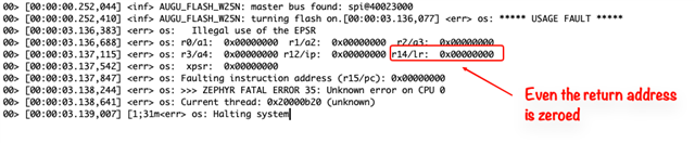

    00> [00:00:00.250,396] <inf> AUGU_GPIO_POWER: augu_power_resource_init: boost_on_node
    00> [00:00:00.250,793] <inf> AUGU_GPIO_POWER: augu_power_resource_init: hw_id_on_node
    00> [00:00:00.251,220] <inf> AUGU_GPIO_POWER: augu_power_resource_init: sensors_on_node
    00> [00:00:00.251,617] <inf> AUGU_GPIO_POWER: augu_power_resource_init: flash_on_node
    00> [00:00:00.252,044] <inf> AUGU_FLASH_W25N: master bus found: spi@40023000
    00> [00:00:00.252,410] <inf> AUGU_FLASH_W25N: turning flash on.[00:00:03.136,077] <err> os: ***** USAGE FAULT *****
    00> [00:00:03.136,383] <err> os:   Illegal use of the EPSR
    00> [00:00:03.136,688] <err> os: r0/a1:  0x00000000  r1/a2:  0x00000000  r2/a3:  0x00000000
    00> [00:00:03.137,115] <err> os: r3/a4:  0x00000000 r12/ip:  0x00000000 r14/lr:  0x00000000
    00> [00:00:03.137,542] <err> os:  xpsr:  0x00000000
    00> [00:00:03.137,847] <err> os: Faulting instruction address (r15/pc): 0x00000000
    00> [00:00:03.138,244] <err> os: >>> ZEPHYR FATAL ERROR 35: Unknown error on CPU 0
    00> [00:00:03.138,641] <err> os: Current thread: 0x20000b20 (unknown)
    00> [00:00:03.139,007] [1;31m<err> os: Halting system
    another strange things that after dfu fails with mcuboot v3.0.2 i hae to flash the device twice with an older version for it to start working again, after first flash of the merged hex with --chiperase trying to reset or power off and power on the device just don't do it .. i wonder why it gets sttuck like this and why the second flashing of the same merged he as the first flash fixed it.
    hope to read you soon
    best regards
    Ziv

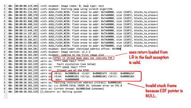

    i also tried increasing the stack for mcuboot CONFIG_MAIN_STACK_SIZE=10240 (it was set to 2k before)
    and i got this after dfu:
     [1779893114] <inf> mcuboot_util: Image index: 0, Swap type: none
    00> [1779893114] <inf> mcuboot_util: Image index: 0, Swap type: none
    00> [1779893114] <inf> SMP_SERVICE: dfu has started. configuring connection watchdog to 10 minutes
    00> [1779893114] <inf> COMM_MNG: ble_connection_config updated!
    00> [1779893114] <inf> AUGU_FLASH_W25N: flash erase to addr: 0x7980000, size 655360, blocks_to_erase=5
    00> [1779893114] <inf> mcumgr_img_grp: Erased 0xa0000 bytes of image slot
    00> [1779893114] <inf> AUGU_FLASH_W25N: flash erase to addr: 0x7a40000, size 131072, blocks_to_erase=1
    00> [1779893114] <inf> mcumgr_img_grp: Erased 0x20000 bytes of image slot trailer
    00> [1779893115] <inf> COMM_MNG: le_param_updated: LE conn param updated: interval 0x0006 latency 0 timeout 400
    00> [1779893115] <inf> COMM_MNG: RSSI is -45
    00> [00:00:00.251,190] <inf> AUGU_GPIO_POWER: augu_power_resource_init: sensors_on_node
    00> [00:00:00.252,014] <inf> AUGU_FLASH_W25N: master bus found: spi@40023000
    00> [00:00:00.252,380] <inf> AUGU_FLASH_W25N: turning flash on...
    00> [00:00:00.252,716] <inf> AUGU_FLASH_W25N: flash_w25n_spi_init done
    00> [00:00:00.253,051] <inf> AUGU_FLASH_W25N: spi init ok
    00> [00:00:00.253,356] <inf> AUGU_FLASH_W25N: power on ok, sleeping 50ms
    00> [00:00:00.303,771] <inf> AUGU_FLASH_W25N: reading jedec id (1)
    00> [00:00:00.304,138] <inf> AUGU_FLASH_W25N: reading jedec id (2)
    00> [00:00:00.304,534] <inf> AUGU_FLASH_W25N: flash jedec device id 0xefba21
    00> [00:00:00.306,945] <inf> AUGU_FLASH_W25N: bad block management lut markdown found
    00> [00:00:00.307,342] <inf> AUGU_FLASH_W25N: flash_w25n init done
    00> *** Booting My Application v2.1.0-dev-ae1ee57f3906 ***
    00> *** Using nRF Connect SDK v3.0.2-89ba1294ac9b ***
    00> *** Using Zephyr OS v4.0.99-f791c49f492c ***
    00> [00:00:00.308,288] <inf> mcuboot: Starting bootloader
    00> [00:00:00.313,262] <inf> mcuboot: Primary image: magic=unset, swap_type=0x1, copy_done=0x3, image_ok=0x3
    00> [00:00:00.313,751] <inf> mcuboot: Scratch: magic=bad, swap_type=0x1, copy_done=0x2, image_ok=0x2
    00> [00:00:00.314,208] <inf> mcuboot: Boot source: primary slot
    00> [00:00:00.319,488] <inf> mcuboot: Image index: 0, Swap type: test
    00> [00:00:03.216,064] <inf> mcuboot: Starting swap using scratch algorithm.
    00> [00:00:03.216,491] <inf> AUGU_FLASH_W25N: flash erase to addr: 0x7a60000, size 131072, blocks_to_erase=1
    00> [00:00:03.309,570] <inf> AUGU_FLASH_W25N: flash erase to addr: 0x7a60000, size 131072, blocks_to_erase=1
    00> [00:00:03.858,398] <inf> AUGU_FLASH_W25N: flash erase to addr: 0x7a40000, size 131072, blocks_to_erase=1
    00> [00:00:03.860,290] <inf> AUGU_FLASH_W25N: flash erase to addr: 0x7a00000, size 131072, blocks_to_erase=1
    00> [00:00:08.480,316] <inf> AUGU_FLASH_W25N: flash erase to addr: 0x7a60000, size 131072, blocks_to_erase=1
    00> [00:00:09.029,144] <inf> AUGU_FLASH_W25N: flash erase to addr: 0x79e0000, size 131072, blocks_to_erase=1
    00> [00:00:13.648,193] <inf> AUGU_FLASH_W25N: flash erase to addr: 0x7a60000, size 131072, blocks_to_erase=1
    00> [00:00:14.197,021] <inf> AUGU_FLASH_W25N: flash erase to addr: 0x79c0000, size 131072, blocks_to_erase=1
    00> [00:00:18.817,993] <inf> AUGU_FLASH_W25N: flash erase to addr: 0x7a60000, size 131072, blocks_to_erase=1
    00> [00:00:19.366,821] <inf> AUGU_FLASH_W25N: flash erase to addr: 0x79a0000, size 131072, blocks_to_erase=1
    00> [00:00:23.986,083] <inf> AUGU_FLASH_W25N: flash erase to addr: 0x7a60000, size 131072, blocks_to_erase=1
    00> [00:00:24.534,912] <inf> AUGU_FLASH_W25N: flash erase to addr: 0x7980000, size 131072, blocks_to_erase=1
    00> [00:00:30.364,501] <inf> mcuboot: Bootloader chainload address offset: 0xf000
    00> [00:00:30.364,898] <inf> mcuboot: Image version: v2.2.3
    00> [00:00:30.365,203] <inf> mcuboot: Jumping to the first image slot
    00> [00:00:30.365,539] <err> os: SPSEL in thread mode does not indicate PSP
    00> [00:00:30.365,539] <err> os: ***** HARD FAULT *****
    00> [00:00:30.365,539] <err> os:   Fault escalation (see below)
    00> [00:00:30.365,539] <err> os: ***** USAGE FAULT *****
    00> [00:00:30.365,539] <err> os:   Illegal use of the EPSR
    00> [00:00:30.365,539] <err> os: r0/a1:  0x20009bc8  r1/a2:  0x00002d75  r2/a3:  0x0000a2ef
    00> [00:00:30.365,539] <err> os: r3/a4:  0x00002d61 r12/ip:  0x00002d61 r14/lr:  0x00002d61
    00> [00:00:30.365,539] <err> os:  xpsr:  0x00000000
    00> [00:00:30.365,539] <err> os: Faulting instruction address (r15/pc): 0x00002d61
    00> [00:00:30.365,539] <err> os: >>> ZEPHYR FATAL ERROR 35: Unknown error on CPU 0
    00> [00:00:30.365,539] <err> os: Current thread: 0x200019a0 (unknown)
    00> [00:00:30.365,539] [1;31m<err> os: Halting system
    i also understand that mcuboot on ncs3.0.2 is a bit bigger and uses some other encryption that maybe require more stack .. maybe that is related somehow ?
  • These crash logs are strange and difficult to make sense of:
    and it is not really possible to pinpoint what the problem is based on these alone.
    As a next step, I suggest you compare/diff the generated .config file from your new and old MCUBoot build located in <build dir>/mcuboot/zephyr/ to see if anything stands out. You can also build the bootloader with CONFIG_EXTRA_EXCEPTION_INFO=y to have the handler print out the actual SP and and exec return values.
    CONFIG_MAIN_STACK_SIZE should be set to 10k by default. Not sure why it was only 2k, but that is too little for the bootloader.
