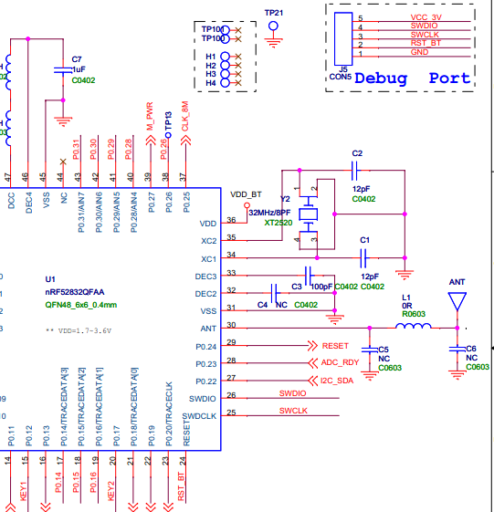

according to error's hint, I add --log after --program "#H" -f NRF52 --chiperase --log and get the log text. pls refer the attached file.JLinkARM.log.txt but i can't find the reason. if we use the same project to program it on EVB PCA10040, it is ok. why ? Is the different between the EVB PCA10040 's JLINK and our JLINK cause the issue? how to fix it? Thanks.
  • On our board,it still failed. using cmd nrfjprog -f nrf52 --recover and nrfjprog -f nrf52 -e are ok. but using cmd nrfjprog -f --program .hex that failed and report above error info. if use the same cmd to progamm your EVB pca10040 that is ok. it report info as below:
    D:\project\VOX02_OLED\code\examples\ble_peripheral\nrf5-ble-tutorial-service\pca 10040\s132\arm5_no_packs>nrfjprog --program merge_image.hex Parsing hex file. Reading flash area to program to guarantee it is erased. Checking that the area to write is not protected. Programing device.
    D:\project\VOX02_OLED\code\examples\ble_peripheral\nrf5-ble-tutorial-service\pca 10040\s132\arm5_no_packs>pause. why is there the difference? Our Factory plan to use the cmd group to program mass production. But now , it was hold.
  • Well, if you're able to program the nRF52 DK(PCA10040) then this cannot be an issue with your J-Link driver setup. Which J-Link debug probe are you using(J-Link Pro, Ultra+, Plus or Base)? Could you also attach a picture or schematic showing how the debug probe is connected to your custom board?
  • We can debug our board by our J-Link with port SWD and program our board by JFlash. We have developed my product successfully.it mean that my J-link debug probe is ok and why using nrfjprog erase cmd that is ok but using nrfjprog program cmd that failed on our board. Now in production stage, we want to use your nrfjprog cmd group to progarm mass production in factory efficiently .Another, how to upload the attached picture or schematic to your devzone site? I can't find the way.
  • pls find th attached picture about J-link debug probe.image descriptione
