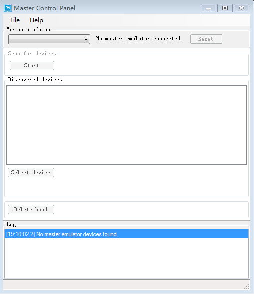

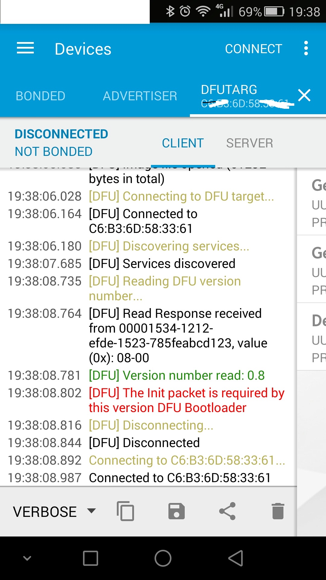

  • I have tried,but I don't know how to use the MCP ,When I open it,it can't work.It seems to need connect other board.image descriptionWhat does the program use for? I have try hardly,but I can't find a easier way to solute the problem.Could you show me the detail of operation step.I use the android MCP -> nrf master control panel to update ,It doesn't work like you say.When I choose hex file ,the MCP doesn't auto init the hex file format for S130 duf ,and disconnect .As the picture shows image description Besides ,how to generate a .zip file?
  • I already answered how you generate .zip file: "Note that included in MCP (in Program File(x86) folder) you can find nrfutil tool that can be used to generate the DFU .zip file (the init packet and the binary image in a zip file) so you dont have to generate on your own."
    To use MCP you need a nRF51 dongle or a nRF51 DK and click File -> Flash Programming to flash the board with the firmware needed.
    If you want to use with nRF Connect (nRFMCP) on Android you can generate the .zip file from your PC and then copy to your phone and do DFU.
