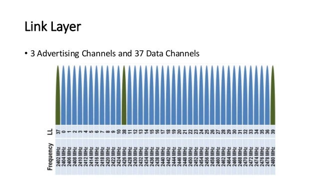

1->When i come with multiple beacons(let us consider 4 beacons) near to receiver or scanner ,does (ble_app_hrs_c) example receives all the advertisement packets from all 4 beacons at regular interval of time. 2->Is there any missing of packets at receiver end?? 3->how can i receive all the advertisement packets in scanner ,do i need to change the scanning interval or connecting,non connecting modes ??

    2. Yes, the central will scan on all 3 advertising channels (37,39 and 39). When you send an advertising packet from the peripheral, the peripheral will actually send the packet on all 3 advertising channels. It will first send it on channel 37, then on 38 and then on 39.
    image description
