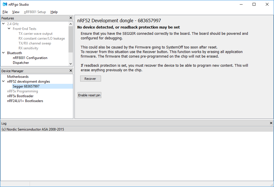

I have nRF52840 dev board which was detected and LEDs were coming on. I tried programming the prebuilt throughput hex file in nRFgo Studio.
C:\Projects\NORDIC\nRF5_SDK_14.0.0_3bcc1f7\examples\ble_central_and_peripheral\experimental\ble_app_att_mtu_throughput\hex\ble_app_att_mtu_throughput_pca10056_s140.hex
Now, no LEDs come on, it isn't detected as a drive on the PC and I can't find/erase it using nRFgo Studio of the command line tool.
I have a second board which does light up (factory default program) which I haven't reprogrammed. I need two for the throughput demo.
(1) Have I "bricked" one of the boards? (2) Is there a way of recovering it?
The power source switch is on VDD The other switch is on Default

    I tried the bootloader.
    Unfortunately there was no difference.
    Just checking I am doing it right:
    • Hold BOOT RESET
    • Connect USB to External Supply (not nRF USB)
    • File Explorer displays Bootloader folder
    • Drag bootloader .bin file onto drive.
    • Once file is copied Bootloader folder disappears and LED on dev board flashes.
    • LED continues to flash until USB cycled
    • Board appears as JLINK drive on PC
    At this point I would expect to be able to erase the device using nrfjprog -e or program it by dragging the ble_app_att_mtu_throughput_pca10056_s140.hex file onto the drive and cycling the USB. Neither works.
    I have pasted the latest log outputs much further below.
    Question
    Can you please point me towards where I can find more information about how to copy from one device to another?
    I've found P19 and P18 and can get a cable made up.
    Not sure what the process is.

    nrfjprog --program ble_app_att_mtu_throughput_pca10056_s140.hex --log
    nrfjprog verion 9.7.0
    FUNCTION: open_dll.

    Device "NRF52832_XXAA" selected.
    FUNCTION: read_connected_emu_snr.
    FUNCTION: read_device_family.
    JLinkARM.dll CORESIGHT_WriteAPDPReg returned error -1.
    JLinkARM.dll CORESIGHT_WriteAPDPReg returned error -102.

    Screen Shots
    image description
    image description
    image description
  • You can find more information about the Debug in/out port here and here.
    Note that if you have done any modification to the solder bridges, you should restore them to default state.
    • Have you tried a different USB cable? Faulty cables are surprisingly often the issue.
    • Can you measure the supply voltage on the nRF Device? The error indicates that the debugger is not able to detect the device, and is normally shown when there is a mechanical issue with the wiring or connectors (a contact issue).
    • Can you try this guide? devzone.nordicsemi.com/.../
