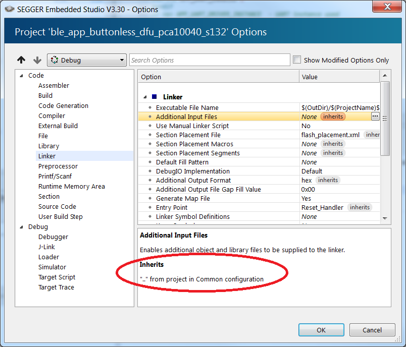

I try to add default nRF sdk libs in Segger studio. All files exist and path corect.
in nutshell i try to add uart module to default ble_app_buttonless_dfu example

Can you click on "Additional Input Files" and check if it say anything under Inherits, as shown in below image? Also, try left clicking it and select "Use inherited value", anc check under "Common" configuration if anything is configured in this field there (should reflect what shown under "Inherited" as shown in below image).
Additional Input Files say under Inherits same things as in User Include Directories
It looks like you have set the "Additional Input Files" configuration in the solution options, not in the project options. Left click "Solution 'ble_app_buttonless...'" in the Project Items window and remove the settings.
