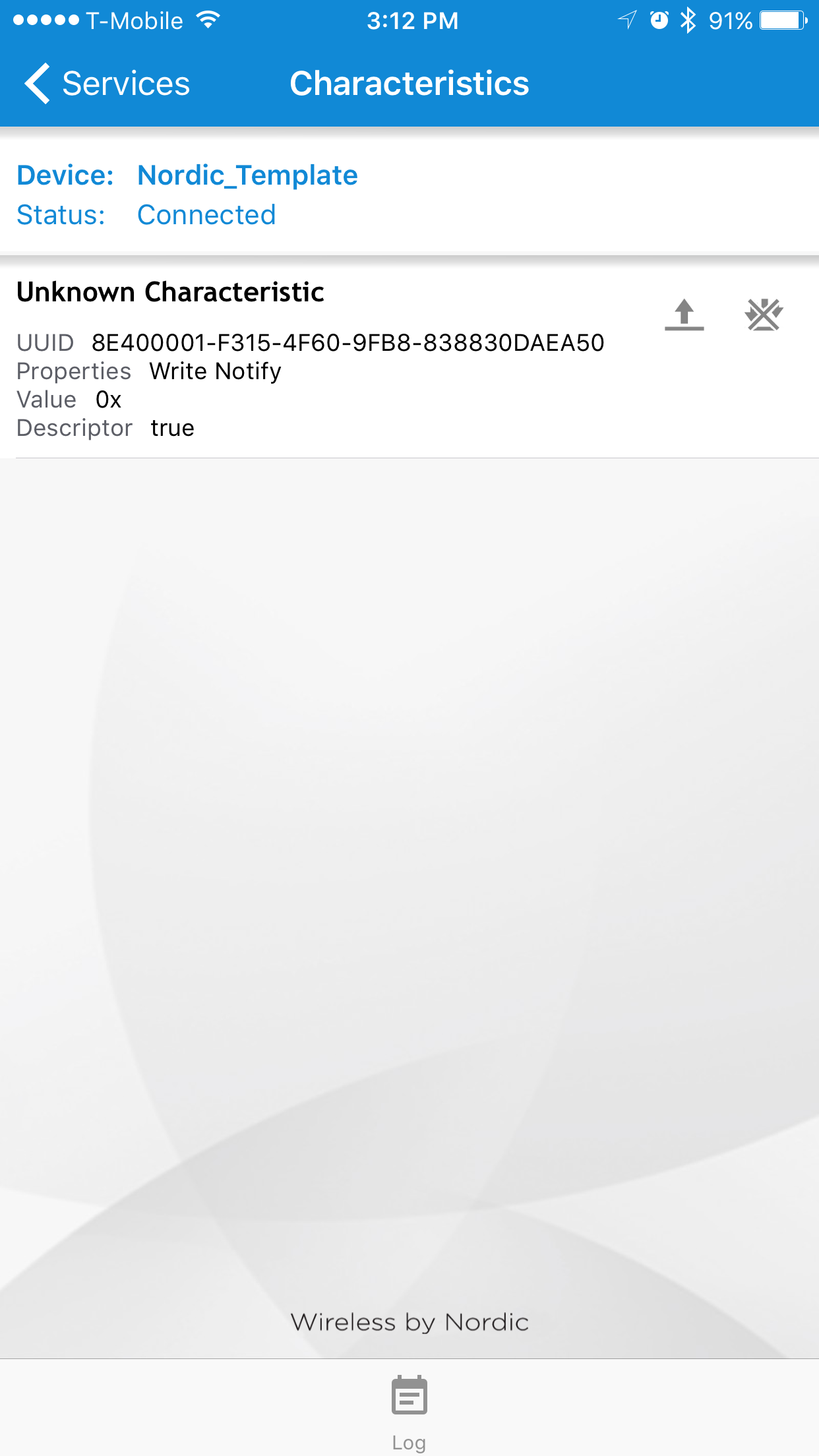

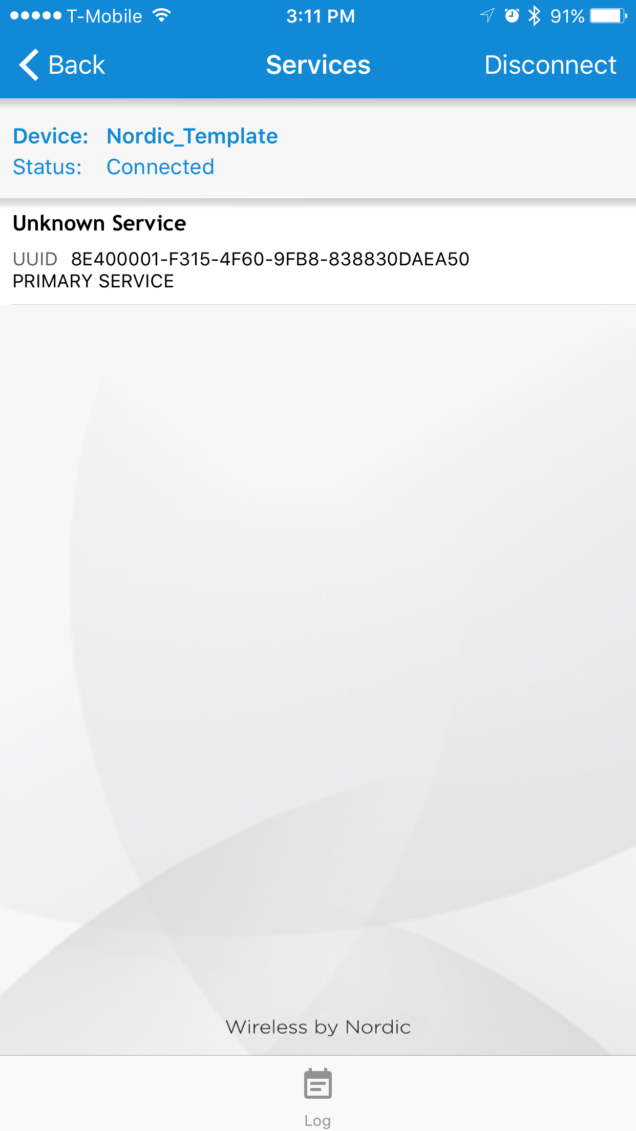

    Connect with the device "Nordice_Template" via IOS nRF Connect and discover the "Unknown Service".
    Unknown Service
    Click on the service to discover the "Unknown Characteristics". Click on the right button (3 parallel arrows down button) to enable the service.
    Unknown Char
    The button will turn into a cross out arrow down as below.
    Enabled Char Service

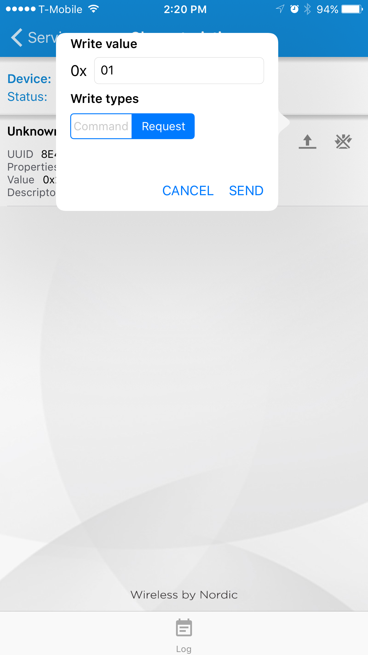

    Click arrow up button to write 0x01 to the characteristics
    Service enabled

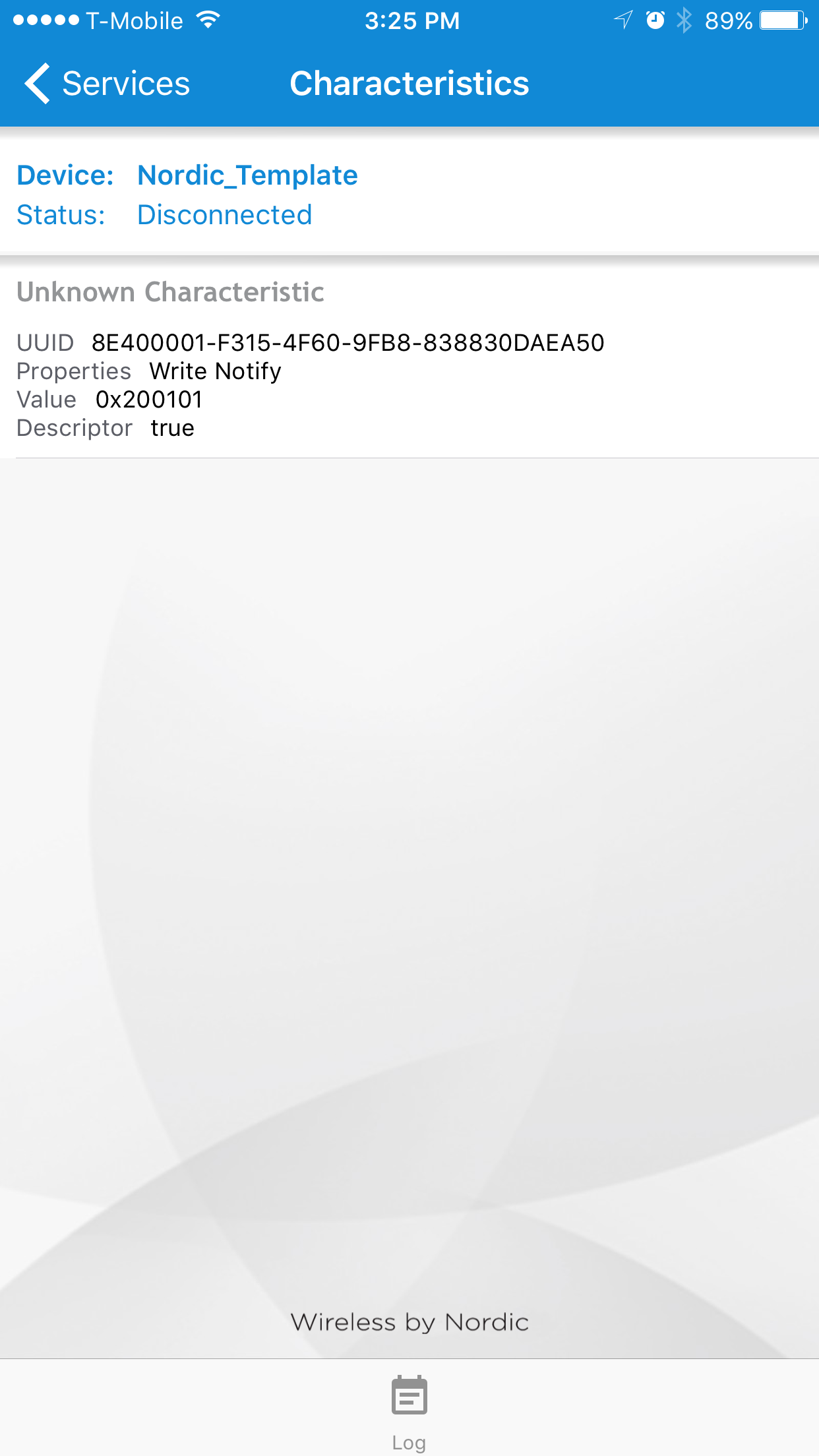

    The value will change to 0x200101. The device will be disconnected and the nRF51 DK will light up the LED 3.

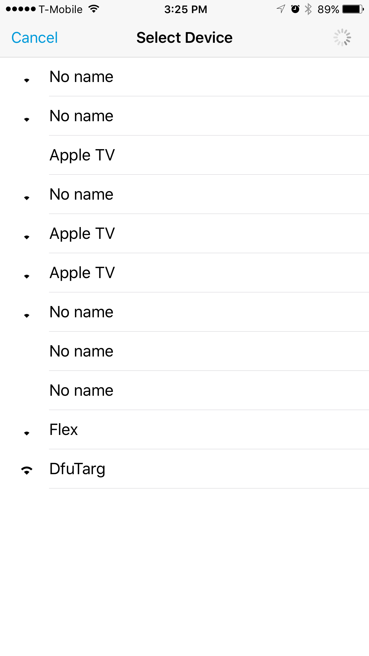

    Find the device advertised as "DfuTarg" in nRF Toolbox and select it as DFU target.
