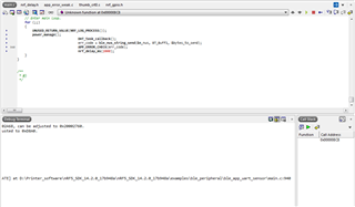

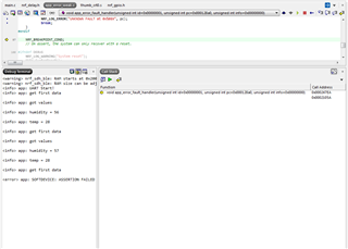

Hi all,
I am working on Temperature and Humidity(DHT11) with nrf52832, After advertising the Bluetooth  i am calling the DHT11 sensor function in loop, few seconds it is working fine, after sending some data it is not sending data over the BLE_NUS, i am not getting where is the issue, Please suggest me for this.
  • Hi Jorgen,
    Here  i am attaching another code this is working for more one minutes

    void DHT_task_callback(void)
    				//uint8_t BT_Buff[20],BT_Buff1[20], str[20] = "ADC 1234";
    				//uint16_t bytes_to_send = 20;
    				ret_code_t err_code;
    				//while(1)
    						//while(ble_nus_string_send(&m_nus, str, &bytes_to_send) != NRF_SUCCESS);
    						NRF_LOG_INFO("get first data\n");
    						printf("get first data\n");
    						DHT11_START_SEQUENCE();
    						err = DHT11_READ_5_BYTES_DATA();
    						if(err == 0)
    								Convert_Humidity_Temperature_Values(Humidity_Int);
    								//NRF_LOG_INFO("Humidity %d\n",(int)Humidity_Int);
    								decimal_value2 = ((decimal_value2&0x0f)|0x30);
    								decimal_value1 = ((decimal_value1&0x0f)|0x30);
    								NRF_LOG_INFO("humidity = %c%c\n",decimal_value2,decimal_value1);
    								printf("humidity = %c%c\n",decimal_value2,decimal_value1);
    									sprintf((char *)BT_Buff,"HUM-%d",Humidity_Int);
    								//while(ble_nus_string_send(&m_nus, BT_Buff, &bytes_to_send) != NRF_SUCCESS);
    								//nop();
    								Convert_Humidity_Temperature_Values(TEMPERATURE_Int);
    								//NRF_LOG_INFO("Temperature = %d\n", (int)TEMPERATURE_Int);
    								NRF_LOG_INFO("temp = %c%c\n",decimal_value2,decimal_value1);
    								printf("temp = %c%c\n",decimal_value2,decimal_value1);
    								sprintf((char *)BT_Buff1,"Temp-%d",TEMPERATURE_Int);
    								strcat(BT_Buff1, BT_Buff);
    								//while(ble_nus_string_send(&m_nus, BT_Buff1, &bytes_to_send) != NRF_SUCCESS);
    								// nop();
    								//ip++;
    						nrf_delay_ms(500);
    void DHT11_START_SEQUENCE(void)
    			DHT11_DIR_OUTPUT();
    			nrf_gpio_pin_write(DHT11_ONE_WIRE_INPUT_PIN, level_1);
    			//DHT11_ONE_WIRE_OUTPUT_PIN = 1;
    			nrf_gpio_pin_write(DHT11_ONE_WIRE_INPUT_PIN, level_0);
    			nrf_delay_ms(25);
    			//ets_delay_us(22000);
    			//	Delay_micro_second(30);
    				nrf_delay_us(30);
    			DHT11_DIR_INPUT();
    			Count_micro_second = 0;
    			//while(DHT11_ONE_WIRE_INPUT_PIN==0)
    			while(nrf_gpio_pin_read(DHT11_ONE_WIRE_INPUT_PIN)==0)
    			//	printf("waiting for make line high by dht11\n");
    				nrf_delay_us(1);
    			test_start_seq2 = Count_micro_second;
    			//	while(DHT11_ONE_WIRE_INPUT_PIN==1)
    			while(nrf_gpio_pin_read(DHT11_ONE_WIRE_INPUT_PIN)==1)
    					//printf("waiting for make line low by dht11\n");
    					nrf_delay_us(1);
    			test_start_seq3 = Count_micro_second;
    char DHT11_READ_5_BYTES_DATA(void)
    				//vTaskSuspendAll ();
    				err = 0;
    				Humidity_Int = DHT11_READ_1_BYTES_DATA();
    				Humidity_DEC = DHT11_READ_1_BYTES_DATA();
    				TEMPERATURE_Int = DHT11_READ_1_BYTES_DATA();
    				TEMPERATURE_DEC = DHT11_READ_1_BYTES_DATA();
    				CHECKSUM = DHT11_READ_1_BYTES_DATA();
    //				printf("datas = %c %c\n",Humidity_Int,TEMPERATURE_Int);
    				if (((Humidity_Int + Humidity_DEC + TEMPERATURE_Int + TEMPERATURE_DEC) & 0xff) != CHECKSUM)
    					NRF_LOG_INFO("got wrong values\n");
    						printf("got wrong values\n");
    					return 1;
    				else
    					NRF_LOG_INFO("got values\n");
    					printf("got values\n");
    					return err;
    unsigned char DHT11_READ_1_BYTES_DATA(void)
    			unsigned int i=0;
    			unsigned char Return_Value=0;
    			for(i=0;i<8;i++)
    						Return_Value = Return_Value << 1;
    					//printf("inside low");
    					while((nrf_gpio_pin_read(DHT11_ONE_WIRE_INPUT_PIN)) == 0)
    									//	printf("inside low");
    									//NRF_LOG_INFO("inside low1");
    										nrf_delay_us(5);
    					//printf("inside high");
    					//NRF_LOG_INFO("inside high");
    					while((nrf_gpio_pin_read(DHT11_ONE_WIRE_INPUT_PIN))==1)
    								Count_micro_second++;
    								nrf_delay_us(5);
    					if(Count_micro_second<7)
    									Return_Value = Return_Value | 0;

  • Can you post the Call Stack window from Segger Embedded Studio when you end up at the breakpoint (NRF_BREAKPOINT_COND) in the error handler:
    Also make sure you check the error codes from every function that returns an error (ble_nus_string_send, etc.), and pass this to APP_ERROR_CHECK(), to make sure the error handler is called from the correct function call.
  • Hi Jorgen,
    Here i am attaching snaps, while debugging i took this, go through it and suggest me, i need to finish this as soon as possible, thanks in advance
  • Hi Jorgen,
    i have checked with APP_ERROR_CHECK(), so i am getting error in line num 940, Please check in snap
