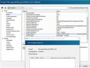

  • You can find the Project Macros, by right clicking on your Project (e.g. Project 'ble_app_blinky_pca10040_s132') in the top left hand corner of SES -> Edit Options ... -> Code tab -> Build tab -> Choosing the Common Configuration -> click on Project Macros.
    See the picture below for more info:

  • The project MACRO's are correct.  I ran the video again and everything looks good.  Java is installed and I have been able to bring up the wizard GUI by invoking the command line from a console window (in Windows 7 Professional).  I do not get a GUI window after calling CMSIS configuration manager in SES using the right hand click on the "sdk_config.h" file in the project window.   The output window does show the following, which makes me believe it has run but was unable to open a new window:
