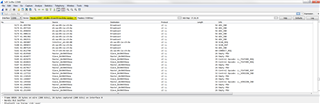

  • HI Nate,
    it should be as simple as selecting the device in the highlighted drop-down menu when it is advertising and then initiate the connection request from the central.
    You should then see the CONNECT_REQ packet and the Source and Destination field should indicate which device is the link master and slave.

  • Ok I have taken a look at the trace. Your application is acting as a broadcaster while its in a connection right? As I am seeing a lot of advertisement packets and scan requests/ responses in the trace.
    I see the connection request, but its a bit wierd that the sniffer does not recognize the empty PDUs and instead sets them as unknown.
    I can also not see any service discovery procedure in the trace either, i.e. like GATTC Primary Service Discovery (note this is for a nrf5x device acting as a central, but we should see the same in the trace when the smartphone performs the discovery) . It could be that the iOS/Android device has cached the services/characteristics so you can try to disable and then re-enable Bluetooth on the smartphone and then perform a new trace.

    From the trace it looks like its the switch from 1Mbit to 2Mbit PHY that is the main contributor to the service discovery taking longer time than SDK 11 where 2Mbit was not supported. This PHY change postpones the service discovery, which is not started until after the LL_Channel_Map_Request
    You can try to force the nRF52 to stay in 1Mbit mode by modifying the BLE_GAP_EVT_PHY_UPDATE_REQUEST case in ble_evt_handler() in main.c to the following
