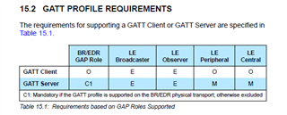

  • What kind of application performance are you referring to? Setting IS_SRVC_CHANGED_CHARACT_PRESENT to 1 will simply include a characteristic in the GATT service, that's it. If you set it to 0 then you remove this characteristic.
  • Yes, that's it. With removing Service Changed characteristic, i can also remove Generic Attribute service.  It will help improve the discovery time and improve our application performance.
  • The GATT Service is mandatory in Bluetooth Low Energy peripheral, you cannot remove it.
    You should also note that most smartphones cache the GATT table of peers so that they do not have to perform service discovery unless a Service Change notification is sent. If you do not add the SC characteristic.
