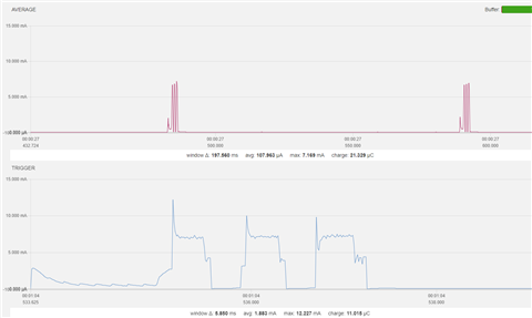

I have done some consumption measurement but I have a strange behaviour while the nRF52840 is in the SYSTEM ON mode.
For the measurement, I send advertising packet each 1 second and then I put the nRF52840 in the SYSTEM ON mode. When the system is in SYSTEM ON mode I measure peak, but I don't know why. Are there any internal process in SYSTEM ON mode that generate these peaks ?
Plot of the measurement:
Test setup :

  • I tested your code on a nRF52840-PDK, and it didn't show any of these peaks here.
    Image from Nordic PPK:
    * If the PDK is connected to a USB-hub, could you try to connect it directly to the computer?
    * Have you connected any external sensors to the PDK ?
    * I see that you have plotted the measurement in Matlab or something similar, did you see the same peaks directly on the Tektronix DMM7510 display also?

    What's the sampling frequency of the Nordic PPK ?
    Yes, I saw the same result on the DMM7510.
