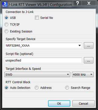

    I have no explanation at this point, and I do not recall ever seeing this issue earlier. A few additional questions:
    • Can you confirm that  you use JLinkRTTViewer.exe to view the logs?
    • Does it have any effect if you disable UART logging (so that you only have RTT logging enabled)?
    • How have you configured the RTT viewer? It should look similar to this:
    • Can you confirm that  you use JLinkRTTViewer.exe to view the logs? No, I'm on Linux so I use JLinkExe and JLinkRTTClient to view the logs. When connecting using JLinkExe I use SWD as the interface
    • Does it have any effect if you disable UART logging (so that you only have RTT logging enabled)? No, I have disabled UART Logging but still no RTT Logs
    • How have you configured the RTT viewer? When using JLinkExe the only option I select is SWD as the interface and then default the rest of selection. This configuration has worked previously.
