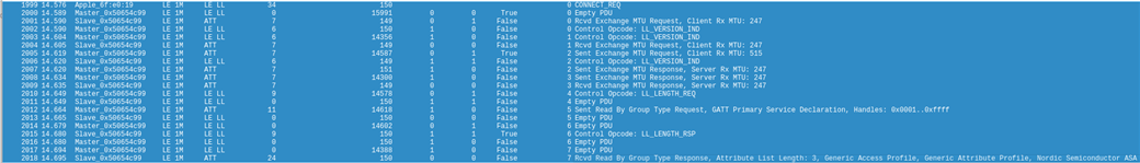

  • Hey all, I wanted to chime in here and share more about the problems this GATT implementation is causing, particularly with Apple products. On some Apple devices it causes two "didConnect" callbacks to occur. I've been able to recreate it reliably on a 2017 Macbook Pro and iPhone 11 Pro Max. When I comment out the Nordic peripheral's MTU request it resolves the issue.
    I suspect there's a race condition in Apple's CoreBluetooth implementation that causes the behavior to occur irregularly across devices. Below is a capture from Wireshark using Nordic's sniffer tool. It captures an "offending transaction" in which both the Macbook and Nordic peripheral both send MTU requests. This particular transaction resulted in the Macbook executing two "didConnect" callbacks.
    Here's the context for my setup:
    - Our Nordic-based product is acting as a BLE Peripheral w/ GATT server implementation exclusively
    - Using nRF5 SDK 15.0.0 and SoftDevice 132
    - The peripheral negotiates a 247 byte MTU
    I think I can comfortably remove the MTU request from my firmware as it's only using GATT server functionality.  My product connects to a specific App on iOS and Android.  On the iOS side, we can always assume that CoreBluetooth will send a client->server MTU request automatically right after connection.  When it comes to Android the Application layer has access to initiating an MTU request, so we'll just have to be sure to initiate that procedure in the Android App code.
    I hope this helps someone who's in a similar boat using Nordic products with Apple.
