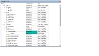

From the stack collected at the point of disconnection, the reason is BLE_HCI_CONNECTION_TIMEOUT and this happens because the supervision timeout is hit (no packets from the peer is received in x seconds).
The stack traces were collected both at remote(central) and peripheral  and both points to BLE_HCI_CONNECTION_TIMEOUT. Attached the stack traces(Remote and wheel).
