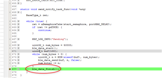

The application uses FreeRTOS. One task handles BLE stack events, and another task sends out notifications. It calls sd_ble_gatts_hvx in a loop until it returns NRF_ERROR_RESOURCES, and then blocks on an RTOS event flag. When the BLE_GATTS_EVT_HVN_TX_COMPLETE event arrives from the BLE stack, the event flag is set and it continues sending.

The effect of the J-Link is strange but repeatable: if the PCA10040 is plugged into the PC USB with no application connected to it, then the problem will occur. But if any J-Link application is running and connected to the debugger then the problem no longer occurs and everything works perfectly. This works with JLink.exe, JLinkRTTViewer.exe, and JlinkGDBServer.exe. I tried changing lots of random things in the project to try to figure out what effect connecting the debugger might have, but nothing worked: disable RTT logging, enable UART logging, request LFCLK and HFCLK, set CONSTLAT power mode, use SYSTICK instead of RTC for FreeRTOS, disable tickless idle, do not enable SCB_SCR_SLEEPDEEP. I assume there must be some kind of race condition somewhere and connecting the debugger makes some slight change to the timing?

The peripheral is in the error_demo directory. To run, copy that directory to nRF5_SDK_15.2.0_9412b96\examples\ble_peripheral in the SDK and run "make flash" from nRF5_SDK_15.2.0_9412b96\examples\ble_peripheral\error_demo\pca10040\s132\armgcc (after flashing S132 SoftDevice). The test app advertises as a device named "ErrorDemo". When a central connects, after a 2 second delay it will start sending notifications from its custom service's characteristic if notifications are enabled. It sends a couple hundred notifications that contain about 50k of data total.
